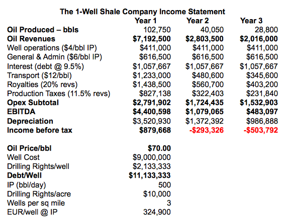

All right, armed with your new degree in shale accounting, let's look at a simple fictional example. The hypothetical One-Well Shale Company obtains property for $10k/acre, then drills and completes a Bakken shale well costing $9M, with an IP of 500 bbl/day, 1st year production: 102k bbl, decline rate 72%. Further, we assume an eventual 3 wells per square mile, and an oil price of $99/bbl.
The income statement shows that with honest accounting, we are barely profitable just looking at the 3-year P&L statement. The price I selected wasn't an accident – I searched for the break-even price and found it at around $99/bbl.
However, will this well at $99/bbl ever make back its drilling costs? It won't, since in the following years, the “fixed costs” for the company will be a heavier and heavier burden on the well whose production declines every year. Likely, $99/bbl is even too low. We can call it a “best case scenario” - only if we assume One Well Shale sells the well to someone else for $986k (the remaining depreciation) at the end of year 3.
What's more, companies have already spent huge sums accumulating land, on which they've drilled a relatively smaller number of wells, so this “One-Well” shale company is definitely fictional. Take OAS, which has 468 wells in production (45k bbl/day = 98 bbl/well) and 779 square miles of land they've bought for $1.8 billion. That's only 0.6 wells per square mile. However, they've already spent the money for the land, so from a “cash flow basis”, they don't really count the land cost when answering the question: “do I want to drill a well here or not.” At this point, money to buy the land is gone, so from a corporate survival standpoint, all they ask is, “if I drop a well, will it pay me back in 3 years?” And in the current environment, they probably only look at year 1 when making this analysis.
But from an overall economic analysis of shale profitability over the longer term, land cost really is an important factor, so we include it in our accounting. If we were to be hard-nosed, we would probably assume a “wells per sq mile” of 0.6, since that's the “actual debt burden” on the real drillers like OAS.
Now lets drop the oil price to $55/bbl and see what happens to One-Well Shale.
Its a sea of red ink. Clearly this well loses money. It cost $9M to drill, and we get back $2M in EBITDA at the end of year 1, the best year for the well. By the end of year 3, EBITDA is negative. It is definitely not worthwhile to drill this well, not even if we assume the land is free.
This represents the average well in the Bakken. At current prices, the average well loses money, no matter how you slice it. So how will this affect capex budgets in 2015? Here's one data point from OAS, a company for whom 100% of their production comes from the Bakken: they are cutting their capex budget in half, choosing only to drill in their better properties. [Source: an awesome, detailed, fact-filled investor document that Google located for me – one wonders if they meant to release it to the public: http://www.oasispetroleum.com/wp-content/uploads/2014/12/2014-12-OAS-IR-PresentationvFINAL.pdf]

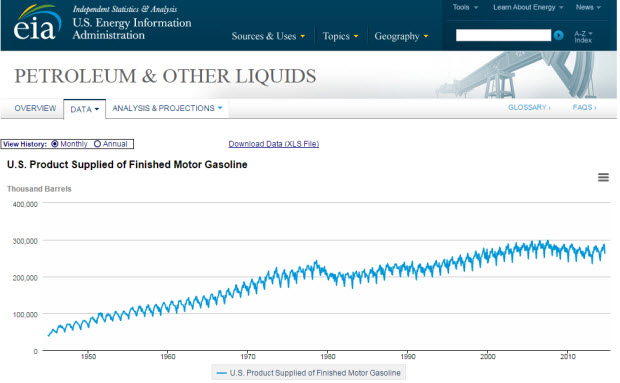

This graph was offered to support the idea that domestic demand for oil is down and that drop in demand is the driver of the collapsing oil price, not "over pumping" by the Saudi's.  DaveF and Chris–does this sound correct to you?  Is this a signal economic downturn?

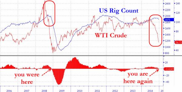

And this to predict the drop in rigs that follow price drops, just as DaveF said.
Sandpuppy - people get that gasoline graph wrong all the time.  That one you have reproduced here is simply for US refinery retail sales of finished gasoline.  I see that one trotted out a lot to purportedly show a huge decline in US demand.
The correct answer lies with the fact that the US imports a lot of finished gasoline mainly from Europe.  They don't need as much gasoline because they use more diesel and we're the opposite in the US.
So the ships pass in the night, gasoline this way, diesel that way.
The correct graph is "supplied finished motor gasoline" and that's this one here:
(Source
As you can see there's a bit of a dip there from 2008 to current, but nothing like what the refiner-only chart shows.
The real story is not about a dip in US demand, but in Asian demand as they have been the main drivers of all demand growth from 2008 to current.
Unfortunately I don't have good info for China/India imports, at least data I feel good about.

Thank you for the article, I am just fleshing out ideas in my mind that you presented.
I put this "how I see it" table together which is off a bit on the details:
  total costs                  # of barrels      100$/b        70$/b        55$/b
drill'n 11133333   year 1    102,750 10275000 7192500 5651250
year 1 2791902   year 2      40,050 4005000 2803500 2202750
year 2 1724435   year 3      28,800 2880000 2016000 1584000
year 3 1532903
total cost 17182573   total three year Rev. 17160000 12012000 9438000
      total Rev -total costs -22573 -5170573 -15598573
So this is how my non-accountant brain sees 'breaking-even' for this really nice idealized well:
  • At 100$ per barrel I am get very close to breaking-even, at under $100k for total rev.- total costs, to paying off all my expenses, including all the costs for the well.  I am close to paying for this project in three years and getting the full gravy profits in the years ahead.
  • At 70$ per barrel I am still $5M off my total costs, so at least I am catching my drilling cost, (catching up to the red queen sort of speak)  so my gravy profits are still a few years in the future.
  •  At 55$ per barrel I am $15.5M off, which is more than I put into just drilling the well in the first place!  So I am going no where fast, giving my barrels of oil away with a few dollar bills stapled to the side of the barrel.  The red queen is running away.
Anyway this helped me understand this a bit better, so I thought I would post it.

Dave,
I don't understand the numbers in the chart above.  The expenses in the rows starting at "Well Operations" and ending at "Production Taxes" add up to about $5.6 million for year 1.  I would expect Opex subtotal to be $5.6 million and EBITDA to be about $1.6 million.  I would then expect the before tax income to be negative even for year one.  What am I missing?

Sterling,
Your total revenue - total costs for year 3 is off.  It should be about  $-7.7 million, so some drilling costs have been recovered, but it looks like year 4 revenue will fall below costs for $55/barrel and maybe approach costs for $70/barrel, so the well is a loser over the long term at these prices.  At $100, it seems the well will go into the black in year 4 using your accounting method.
Check out my question to Dave (#6 above).  Based on my reading of the chart, the expenses are higher than reported which would probably make the well a money loser even at $100.
QB-Good find, your instincts were right!  It was a bad spreadsheet cell - a leftover "what-if" calculation I had done during development.  And I had another error - shale drillers have to pay perhaps $10/bbl to get their oil to market, but they pay royalties and taxes on their realized price (i.e. WTI - $10) rather than on the WTI price.  So two things changed in the model, not just one.
I'm sending the updated sheets to Adam and he'll update the doc.
New break-even for the average well/average company: $99/bbl WTI.

OAS senior secured notes had a coupon of around 7% for 5-7 year maturity.  Not sure when they issued; no way they could get that now.
I adapted freely the concept of depreciation/depletion.  Usually there is some sort of schedule that the company applies to an asset they buy - a computer might be 5 year straight line, a structure (for a building, for instance) might be 27.5 years.  I just took the percentage of lifetime EUR that was pumped that year and multiplied it by the cost of drilling + property rights purchase price.
You can see my spreadsheet here: I uploaded it here rather than fuss around with email: http://www.mdbriefing.com/ows.ods
