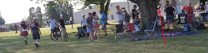

If Ross is the guy behind the tree than this is his location (586683.91m E;4523542.97m N).
A cross reference the footage with line of sights of both footages to find Ross location. Here is the footages project on the ground matching the line of sights of the footages:
Edit: By the same method here is TMX position (586741.77 m E;4523497.44 m N):

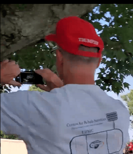

Since you will be there, maybe you can ask around and find out who this guy is?
He has all 8 shots on video (or maybe only 4 shots? :grinning:)
His T-shirt shows UPMC Rehabilitation Institute in PA

Thanks, @vt1 . Yes. Analysis I did of “Ross!” (Michael Difrischia) and Grimley videos indicates that the man you point to with the arrow is Michael Difrischia, the man who recorded the video purchased with exclusive rights by TMZ.

Here are my references for TMX:
1 - the fence (object on Google Earth);
2 - the light pole (object on Google Earth);
3 - Edges of the teleprompter (ref. on drone fottage projected);
4 - trump (location already solidified)
And here are my references for Ross:
1 - edges of the buildings
2 - rotating vent
3 - Crooks position
4 - Alignment of Ross, the tree, and the building in the back from source 4 fottage.
