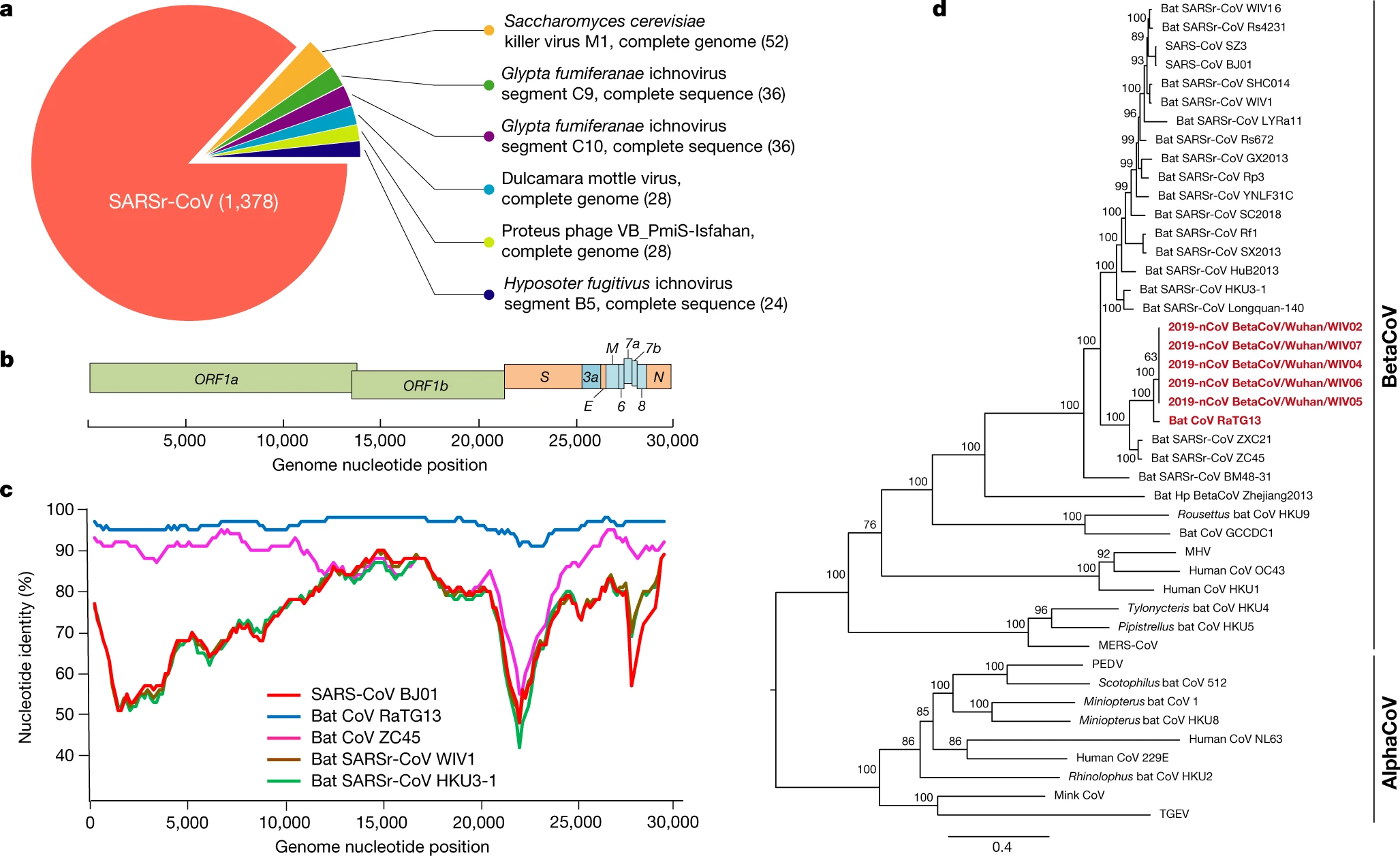

In this photo, you can see a partial phylogenic tree on the right side sorting various viruses based on complete genomes (nucleic acids). We use databases and software tools to compare genomes and these trees are comparative groupings. You can see BetaCoVs and Alphas listed there. The purpose of this specific chart was to underscore the similarity of nCoV-2019 to RaTG13, ZXC21, and ZC45. All of three of those listed viruses have controversial histories and genomes. You can spot SARS-CoV on the top.
When it lists SARSr, that means SARS related virus. Capitalized letters after the initial description denote a city name. Capitalized first letter and lower case second letter indicate the name of the specie they retrieved samples from
Bat-SARSr-Rs672: SARSr (SARS related, but was previously classified as SL or SARS-like). CoV (coronavirus). Rs (Rhinopolus sinicus, also known as the Chinese rufous horseshoe bat which is found in the Yunnan province of China, India, Vietnam, and Nepal). 672 is the sample number.
Another example: Bat-SARSr-CoV-ZXC21 and ZC45. I will do an entire post on these crazy viruses but the breakdown here is that ZC stands for Zhoushan City in Zhejiang, China. Whereas ZXC21 was discovered at a nearby mountain, so to avoid confusion they designated that site as ZXC as opposed to ZC.
Here is a Beta tree that includes the MP789 pCoV (listed as Pangolin-CoV 2020, even though it is from 2019). This tree scoring is the same as the previous, comparing NA of entire genomes. The “groupings” should be obvious to spot.
