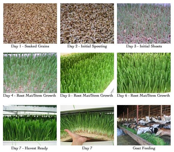

Here is what the growth cycle looks like for barley grass.
The fodder will grow from a dry seed to a 6 -7 inch plant in a little as 6 days. With multiple trays being rotated on a daily basis, once can grow a continuous supply of fresh feed with very little space, power, and water requirements. And the great part is that it is digestible by a great number of animals, from chickens and rabbits, to goat, horses, and cows, this living food can compliment the diets most farm animals.
