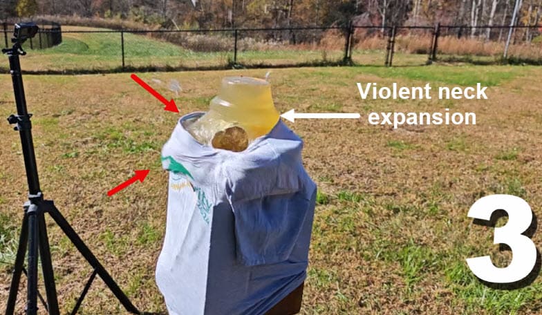

As a second order of business, we wished to see if we could mimic and film the behavior of Charlie’s shirt and broken necklace, which has been the cause of quite a bit of internet speculation.
Many have thought that the movement and puffing out of Charlies shirt must have been the result of an explosion, and worked diligently to explain it that way, but our results clearly show that the cavitation event caused by a high energy rifle round perfectly mirrors what was seen that day.
Only we’ve got it in high def and a high frame rate, so our brains can make better sense of it all.
Three out of three times, the necklace Nick hung around the gel block broke, despite never being hit by a bullet. The cavitation alone was sufficient to break it.
The violence of the .30-06 was captured over and over again in high def, showing almost unbelievable cavitation damage that easily mimicked the chest and neck expansion we saw on Kirk that day, as well as the wild t-shirt movements.
Gel Block Shot #2: Before the shot
Gel Block Shot #2: Frame 3 @ 480 fps (6.25 /1000ths of a second after shot) showing t-shirt flying away from gel block and neck expansion
Gel Block Shot #2: Frame 32 @ 480 fps (66.7 /1000ths of a second after the shot) showing chain broken and cross pendant flying away
