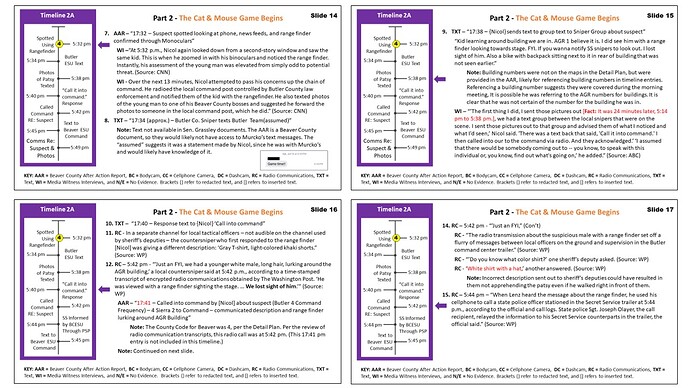

In my detailed analysis of the timeline while Crooks is on AGR property before he gets on the roof (still in progress) I noted issues with these AAR timeline entries.
For the sake of my analysis, I include those as support to the more accurate text message or radio communication evidence. Obviously, that’s different than a pure timeline, but I thought I would share my findings in case you haven’t caught some of these issues already. Here are my detail pages with those timestamps in red.
CORRECTION: I figured out why these AAR Timeline entries are so confusing. Attached are my corrected timeline entries. The resolution is provided in a slater post below.
Notes about AAR entries
  • 17:41 - In your slide you mention Beaver County code, but the ARR states Butler. On page 15 it was stated that local counter snipers were issued a Butler Co. Radio.
  • 17:49 - Most likely refers to the Sen. Ron Johnson entry for 17:45 where a BuC-ESU counter sniper, probably Murcko, contacted USSS. Times differ a bit, but that seems to make sense.
  • 18:00 - Agree with your analysis
Good work on the slides! Updated timeline with information from your slides.

Beaver County code number is 4, per the Detail Plan, which was a Butler County document. They assigned the county code numbers, which the AAR points out, but code 4 was assigned to Beaver.
I had that (following) FBI 5:45 pm comms included with the 17:49 AAR entry as a possible reference, but removed it because it states: “Butler County counter-sniper” and the AAR 17:49 entry clearly relates to the text message they provided to Sen, Grassley. Beaver did likely not have access to Butler comms or texts, as implied by the assumed entry: – “17:34 (approx.) – Butler Co. Sniper texts Butler Team(assumed).”
As for this, I am aware of it, but thanks for bringing it up. My timeline analysis for the activities of Crooks and Nicol while Crooks was on the AGR property, before he climbs on the roof, is being done in 3 parts. Part 2 addressed my sighting number 4 only, because it had all of those radio comms, text messages, and witness statements associated with it. There were also no body or dashcam video evidence for that period, since they all start later. Part 3 will analyze the period between the 6:02 pm sighting and the 6:05 roof access. So the information you point out applies to part 3, which I’m still in the process of analyzing.
Edit: I forgot to update the slide with my revised Sightings Map 2, which more accurately reflects when Crooks was deemed a suspicious person, or at least should have been.
Added: My timeline analysis maps and diagrams now include color codes for Crooks’ change in threat level.
I think there is a difference between Channel and Code. I disagree with no access to Butler comms, but agree with no access to Butler texts. If the ESU did not even share radio channels to command, then the whole Security detail was doomed to fail, very difficult to accept personally.

In the Butler Detail Plan
  • Butler Police OPS 4 (Encrypted)
Edit: So we must determine how many channels Nicol likely had access to. At least 2 by my estimate. Secondly we must determine how many channels existed and that is the difficult part. Minimum 2, but can go as high as 7.

Channel versus code does not apply to that AAR timeline entry, but you are correct in needing to know what radios and channels each player had access to. In another introductory slide I try to address that. (Remember, still a work in progress.) I will have to review your detailed current list more closely. Thanks for sharing it, that would be a big help in better understanding the evidence related to radio comms…
