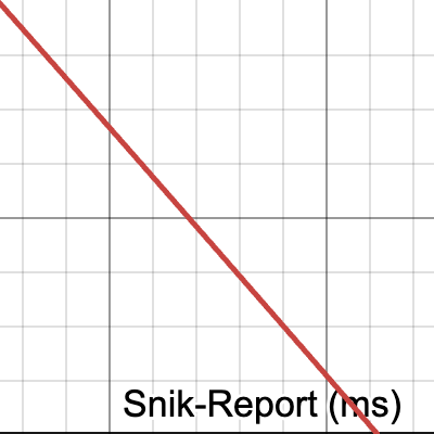

As ε increases, Δt decreases. I plotted this on Desmos for anyone who wants to look and play around with.

If you play around with the bullet velocity slider in the Desmos plot, you’ll see immediately that the ONLY average bullet velocities that make that first shot come close enough to the mic to have hit Trump, but not closer than he actually was, and still yield a 220ms snik-report (Δt) interval, are between roughly 2620 and 2644 fps.
The fact that the snik-report (Δt) time of the 1st shot was the largest is also clear proof that it was the CLOSEST shot to the microphone (and therefore to Donald Trump), which makes sense, because that is the only one that hit him.
The other shots produced snik-report intervals (Δt) that were 5 to 10ms SHORTER.
The measured snik-report (Δt) intervals of 220ms, 215ms, and 209ms for the first three shots imply that those three bullets passed at the following distances from Trump’s microphone:
  • 2.75 ft
  • 8 ft
  • 15.25 ft
