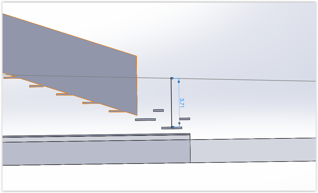

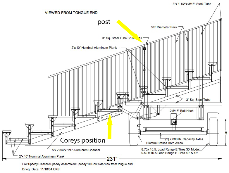

If we get a good estimate of the diameter of those buttons (I think they are control buttons) we can see what the diameter of the hole is.
I think it’s impressive the bullet went clean through that line, considering how thick it was, and that it was steel. You wouldn’t make a like like that out of aluminum.

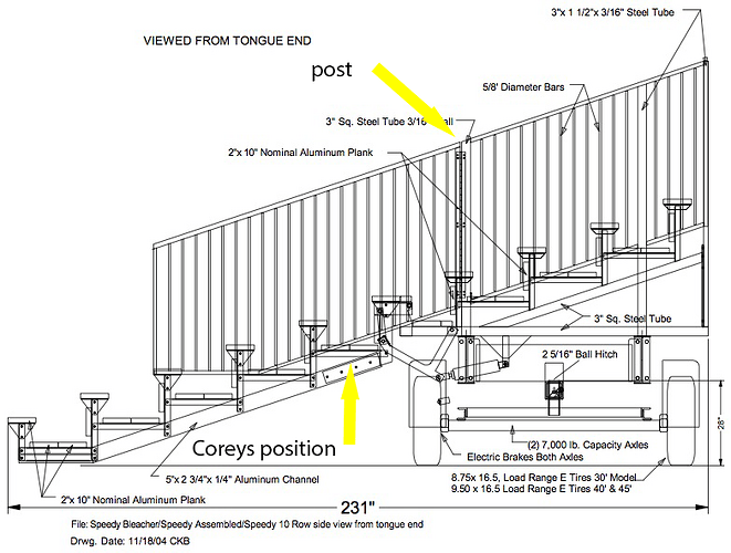

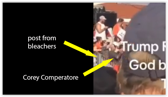

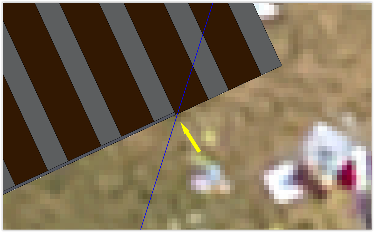

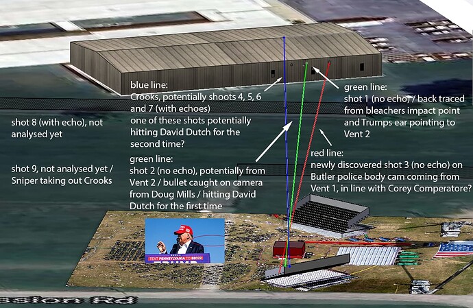

@daniel59 Thank you for providing this video, which allows us to determine Corey Comperatore’s exact position.
By comparing it with the manufacturing drawing, we can see that he was standing on the 5th row.
Therefore, he was precisely in the line of fire of shot 3 coming from vent 1.
It is therefore possible that Corey Comperatore was shot by the person firing from vent 1.

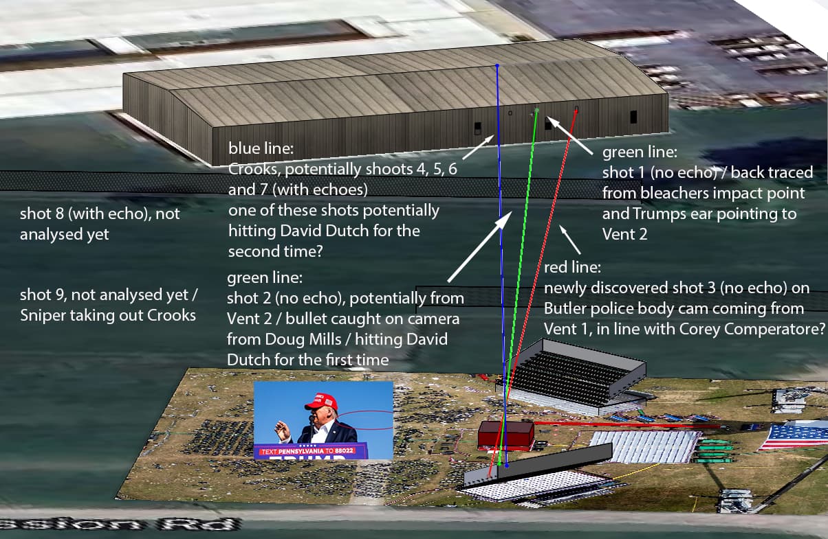

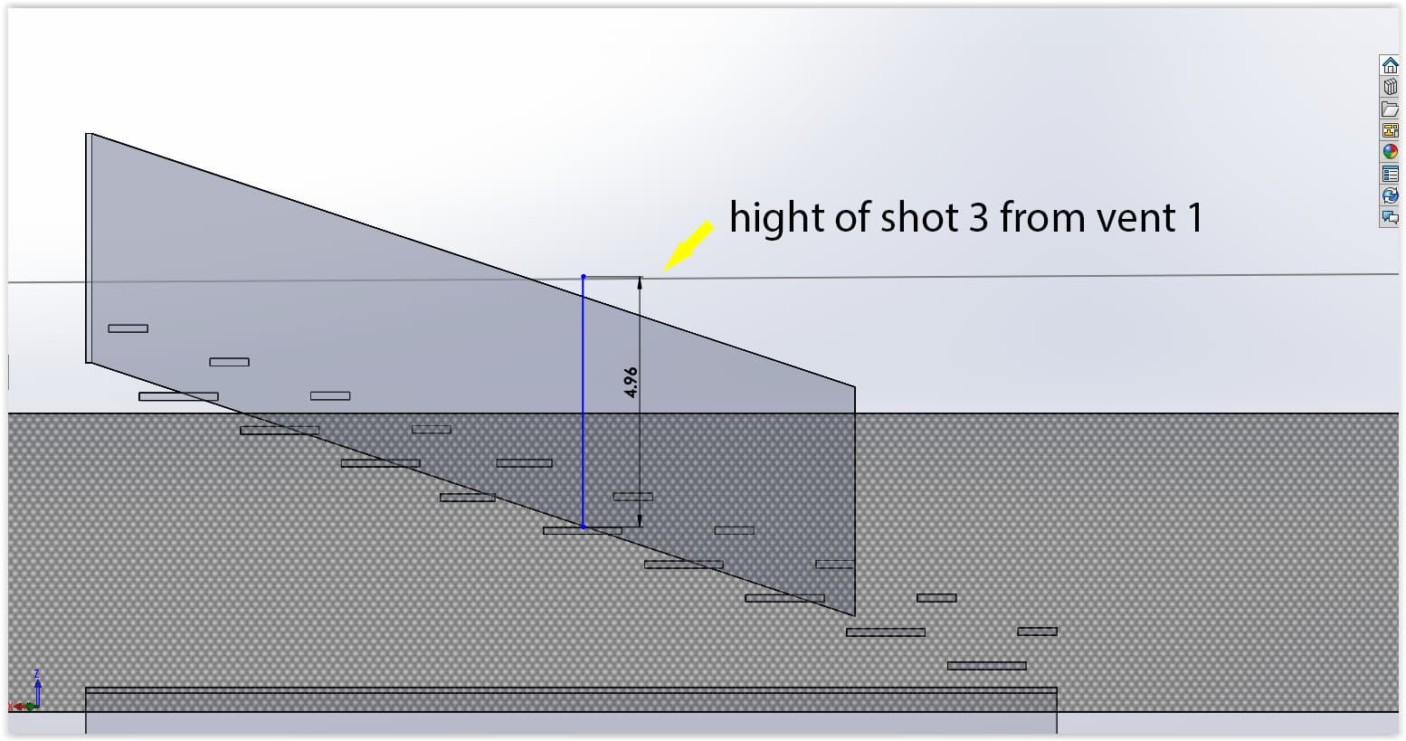

Based on this analysis, I have outlined the following three shots:
  1. Shot 1: Hits Trump’s ear and the left corner of the bleachers (back-traced, likely coming from vent 2).
  2. Shot 2: Hits David Dutch; the bullet was captured on camera by Doug Mills.
  3. Shot 3: Fired from vent 1, captured on the official Butler police camera, potentially hitting Corey Comperatore. This shot may also have struck the hydraulic cylinder (to be verified later).
shot-from-vent-1
Next, we will analyze James Copenhaver.
I find it extremely unlikely that some of the first 3 shots were fired from different weapons at different locations.
Why would the conspirators have opted for such a complex scenario?

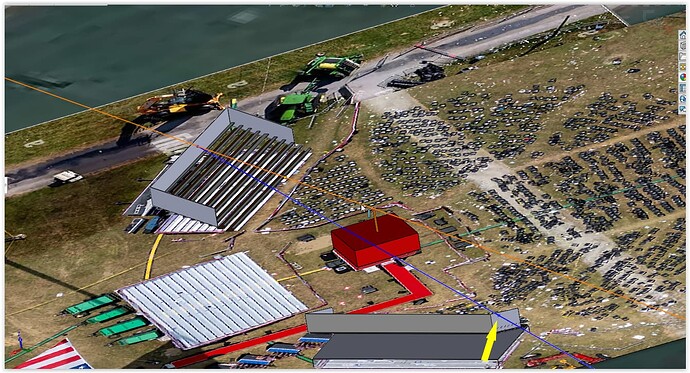

This is not an assumption. Together with everyone here, I have gathered all the data and information and incorporated it into a 3D CAD model. I am simply presenting what the math shows us.
Having video proof that at least one shot came from Vent 1 fundamentally changes the entire scenario. This is not an assumption but evidence: at least one shot did come from Vent 1 of AGR Building 6.
Why do I say that shots 1 and 2 did not come from there?
  1. The video shows Vent 1 clearly during shots 1 and 2, and you can clearly see that no shots are coming from it.
  2. There are precisely two points in space — one being Trump’s ear and the other the bleachers. By connecting these two points, you can calculate the trajectory, which leads back to Vent 2. Unfortunately, Vent 2 is not visible in the video mentioned above.
One possible reflection worth mentioning is that the shooters may have been using bolt-action sniper rifles to increase their chances of hitting the target. This could explain why they were firing from different vents. However, this is only a hypothesis.
I have often been on the wrong track myself. For example, I used to strongly believe that the shots came from the windows. However, I have always updated my 3D CAD model whenever new information became available, and what I am sharing now reflects the most current data.
Can this change in the future? Yes, absolutely. But at this point, I don’t see any arguments that contradict my latest update. As I have always said, if anyone presents me with compelling information, I am always willing to update my data — provided I am personally convinced by the evidence.

The simple point I wanted to make is that it was shot 2, not shot 1, as many people seem to claim.
Daniel, I have always been completely transparent about my data, and I welcome you to challenge any of my points. I will be happy to update them accordingly if you provide convincing evidence.

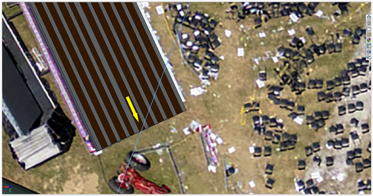

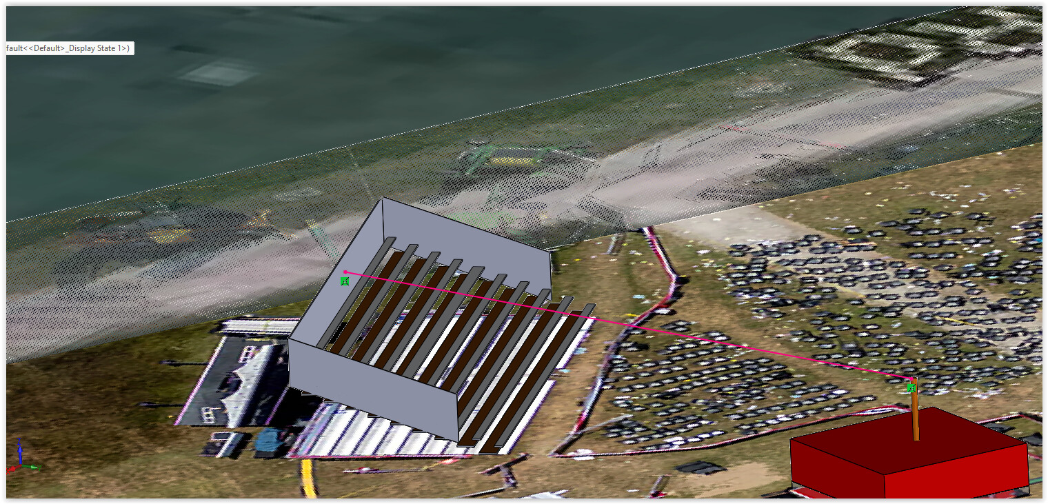

I started with Copenhaver.

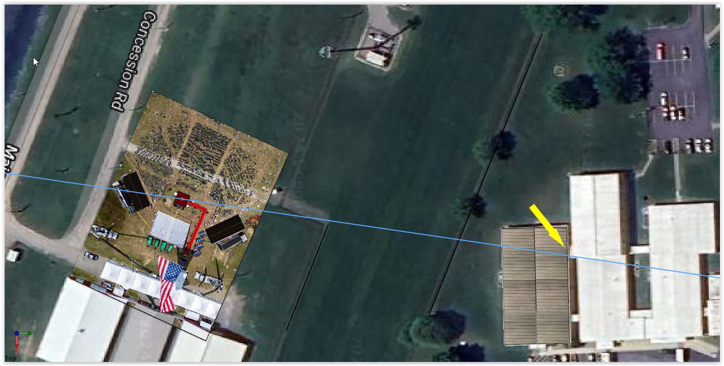

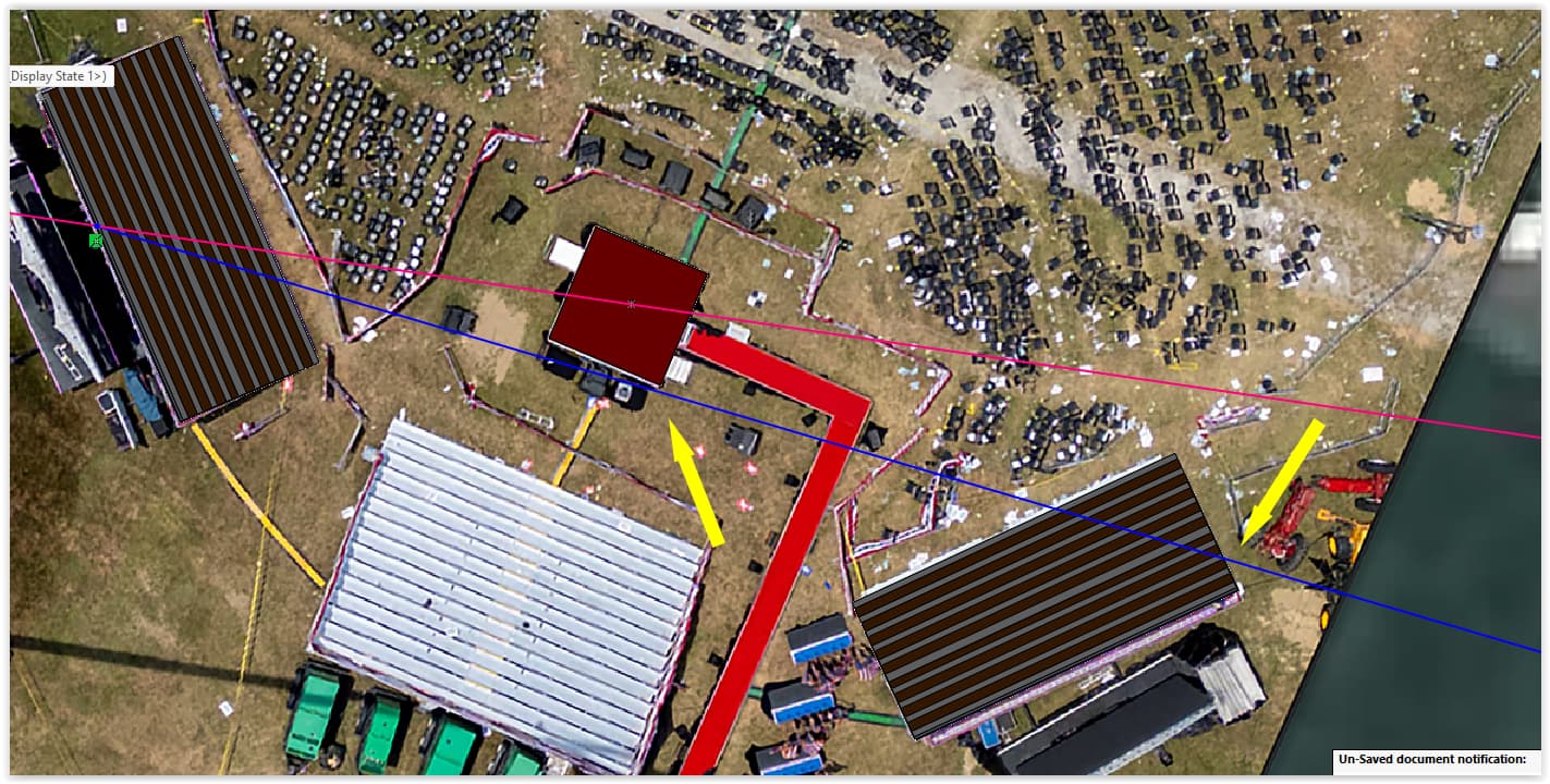

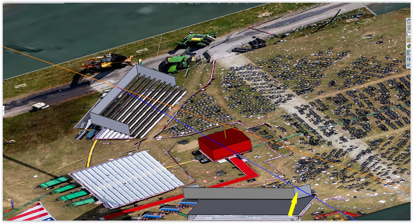

I estimated the point where he was standing and connected it to Trump to see where the trajectory line would lead. As you can see in the background, I have already added the hydraulic piston into the 2D base drawing.

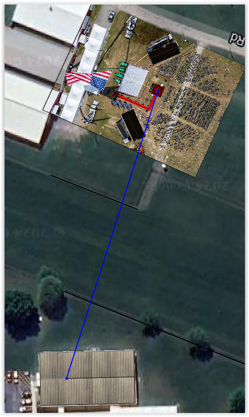

At first glance, it might appear that the shot came from the two-story building. So, @daniel59, I am now forced to include the two-story house in the analysis. :grinning:
One interesting observation at first glance: Crooks’s trajectory seems to collide with the bleachers. It looks like Crooks is in trouble here, and the shot actually passes completely past Trump’s head. This shot from Crooks doesn’t make any sense.
This raises the question — who actually shot Copenhaver? Thanks to daniels video referencing the court case stating that shot 9 did not hit Crooks, perhaps this could in fact be shot 9 comming from the 2 story building?
However, it is still far too early to draw any definitive conclusions. I just wanted to share the latest update with you.
Don’t overlook the fact that we don’t know if Crooks was still lying on shots 4 through 8. Maybe he had straightened up. Then the bleacher might not have been in the way.
One more thing: Please check if Crooks had a line of sight to Donald Trump lying on the ground.
The balding man on AGR4 fired the 1st 3 shots.
If you could point out to me where you think the balding man is located, I can integrate him into the simulation.
However, I believe your sequence of shots is a bit mixed up — but that doesn’t matter. I would be happy to help you evaluate this situation for you.
Very, very close — but no collision. However, if the people in the lower left corner of the bleachers weren’t ducking, they would have been hit.
