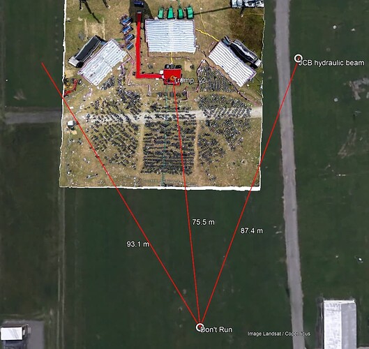

As shown above, for the direct path from the mach cone, the crack traveled 75.5 m to reach the Don’t Run recorder. Looking at the audio waveform, we see that the sound from the right speaker arrives 34 ms after the direct path:
0.034 * c = 11.9 m
75.5 m + 11.9 m = 87.4 m
And that distance matches up well with the right telehandler.
The next sound is heard 50 ms after the direct path.
0.050 * c = 17.6 m
75.5 m + 17.6 m = 93.1 m
I don’t have the location coordinates for the left JCB telehandler, so I drew a line on Google Earth that was 93.1 m long, and as you can see in the image above, it terminates in a reasonable location for the left speaker to be.
