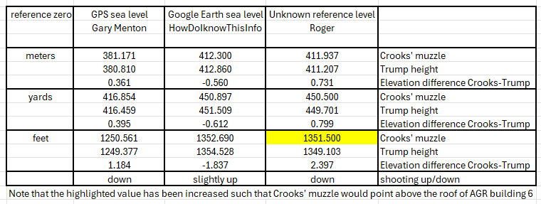

1.5 days ago, Gary Melton from Paramount Tactical brought a great report online. even though it is still preliminary data based on his trip to Butler of last week. in that report, he shows the GPS coordinates of a survey of the area with a drone that is dedicated to geomapping, and this provides really great data…
yesterday, I summarized this information, and here it goes:
so, I have been asking for 1.5 weeks to get the more fine grained ground level data for Trump and where he places the shooter on the low roof, and you can immediately deduce what these figures mean:
even in his model, the shooter was shooting DOWNhill…
as I am using 1.2 meters (3.9 ft) as my estimate for the podium height, I am a little lower, but this does not really make a difference…
so, let me ask you a question… he puts the height of the interaction of the 1st bullet at ground floor level 1336.32+12.21167 = 1348.53 ft = 449.51 yd = 411.03 m, and Trump’s ear is allegedly at 1349.103 ft, how on earth could a back trace algorithm result in a position that is well BELOW the top of the roof of AGR building 6?
