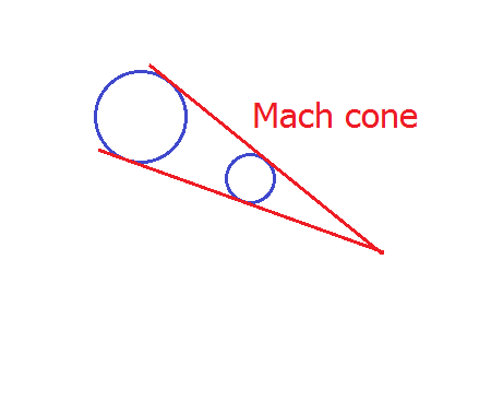

However, people cannot hear the crack everywhere. Simplified textbooks show an eternal Mach cone. But what if the projectile hits the target? The shock-wave won’t just disappear. Let’s follow the evaluation of the truncated cone:
Along the path of the supersonuc projectile, the change in pressure propagetes outward by the speed of the sound. But you can har the crack only at the points of constructive interference.

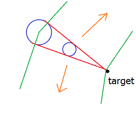

But this is not an infinite cone. The green lines indicate the boundaries. These lines are perpendicular to the cone surface. Actually they are perpendicular cones.

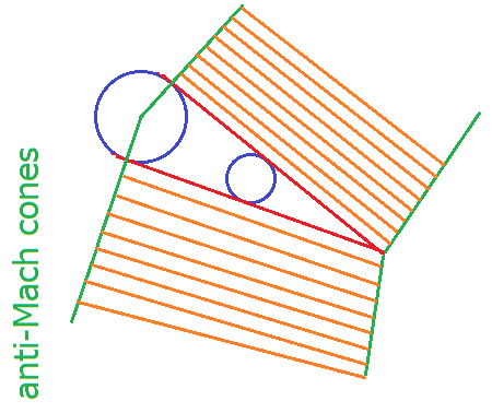

Behind the rear green cone and in front of the frontal one: you cannot hear the crack.
I call them perpendicular boundary cones or anti Mach cones.
So, for example, if the shot comes from a window of north building - most possibly the interviewed people could not hear the crack.
