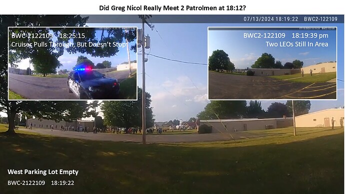

What is the source of dashcam M500-016197? Is this only a still image or do we have footage? First time I saw this one.
Just noting that in slide 2 in the top screenshot, the front vehicle stopped in this position at 18:09:02, as seen in M500-010482. The second patrol car to the left in the top image stopped about the same time as seen in BWC2-122111. 18:08:36 was the moment the two patrol cars was parked next to each other at the base of the water tower.
Edit: We should also take into account that the timeline is between 18:06 and 18:12. It is possible that the two vehicles GN was mentioning are among the three vehicles that was parked at the east end of the parking lot, the vehicles where Stewerd eventually was hiding behind. They could have arrived there between 18:02 and 18:08
The 2 vehicles the report is pointing to, 1 marked and 1 unmarked, are the ones in the dashcam below, at 19:04. You would be hard pressed to go to meet them from a room with no door, when the two vehicles likely weren’t parked there at 18:12, and when you are also on your way to door 9 where 2 vehicles are already parked, 1 marked and 1 unmarked. Last I checked, you can’t walk outside with no door, you can’t meet vehicles that aren’t there at the time, and you can’t be in two places at once. But I could be wrong.
Either the evidence and I are wrong, or the AAR is.
I did have the bodycam references in slide 2 messed up. I fixed them.
At the end of the day we are trying to give GN the benefit of the doubt. We are unsure what vehicles and officers he is talking about and could be any of these three pairs. The truth is that it just does not make sense for GN to go downstairs nor the timelines he stated. Period. He had a radio, he had text groups and he had a job to do. Give overwatch and keep an eye on the persons of interest. He failed.
