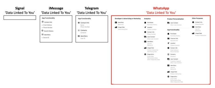

WhatsApp is owned by Facebook. But the words “privacy” and “Facebook” is an oxymoron. Even though Facebook cannot read the contents of your WhatsApp messages, they ‘compensate’ by collecting all other information about you. To show you the difference between Signal and WhatsApp, below is Apple’s App Store’s privacy report for the various messaging apps:
Basically, anything that is not the content of your encrypted messages will be hoovered up by Facebook’s powerful data collection machine. In contrast, Signal wants to collect as little information about you as possible.
