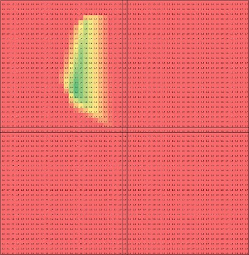

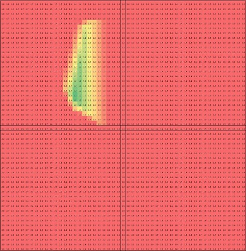

I’m trying to develop a new method for locating the origin of the shots. The method consists in:
1- Obtain the distance from a specified location of the first shot estimate the delta time to synchronize the times of the shot sequence.
2- Then at any other location create a grid where will be tested the specified shot delta time correction subtract from the time from the first calculation.
3- Then this delta time in absolute value is converted to meters for each receiver.
4- Finally, the medium value of error in meters is plotted on the grid.
My results are presented below:
the grid is 4x4 meters with 0.08m between the grids.
Assumptions:
1- Shot 1 came from Crooks Muzzle.
2- Grid center for shot 2 to 8 is Crooks Muzzle geolocation
3- Grid center for shot 9 is the SWAT officer geolocation.
4- Bullet times used from @offtheback:
5- Geolocations from my study.
Bullet 2:
Bullet 3:
Bullet 4:
Bullet 5:
Bullet 6:
Bullet 7:
Bullet 8:
Bullet 9:
Conclusions:
Considering a medium error of 1.4m all bullets from 1 to 8 came from the same location.
Bullet 9 came from the SWAT officer in the middle with a medium error of 2.5m.
Could not evaluate bullet 10 because there is too much error in the report time.
The conclusions are the same of @greg_n work. With different time data then Greg and with a different method.
I did not define the location of the shooter yet. But will work on it. But is for sure that all first 8 bullets came from the same place.
edit: inverted the grid 7 with 9.
Hi @vt1 maybe I don’t understand your heat map. Shots 4-8 look far up and to the left from shot 1. What does up and to the left mean? And does .2 mean .2 meters?
I would suggest you seed it with shot 4 and Crooks’ location and see what that gets you.

The grid is a map of 4x4m with the north pointing up.
So most shots from 2 to 8 are to West and North of the Muzzle geolcation (in the center).
The value in the grid is the error of the method in meters. The error is the medium error of 6 sources.
You can use this image on Google Earth with the side been 4m and put on Crooks muzzle position to see the predicted locations of each shot.
OK. It still seems like if you seed it with the wrong location, things won’t be quite right.
I am working on the premise that Crooks took shot 4 (as the five shot super fast burst seems like a rookie move), using that to sync sources, and then I don’t have to look for shots 5-8 (the last 5 all come from the same place).
Playing around with different groups of sources, if I use sources 2-4, shots 1-3 want to resolve to around 8-9m east of Crooks and 5.5-6m south of Crooks. So in the building.
But that isn’t a better fit for the three crowd sources or DJStew, which prefer more due south of Crooks (but in the building). So trying to understand the differences as to why the east sources want to pull the estimate more east and all the south sources want to pull the estimate more south.
I wonder some times if the estimate for Crooks’ location isn’t quite right. Is your estimate the end of the gun barrel (which is where the sound would emanate from) or something else?

To obtain the shooter location I will try now to reduce the error for all the shots. For now I can only conclude from my method that the location is the same for shots 1 to 8.
If the prediction of distance is always lower regardless of the orientation, then maybe the speed of the sound is bigger than your estimation. I use 351m/s.
The muzzle position is the tip of barrel where the sound originates. For that location I used two lines of sights from DJStew and Ross. Also, I know the length of the barrel (16") and the total length of the gun and consider that to estimate the position of the muzzle from Crooks shoulder.
