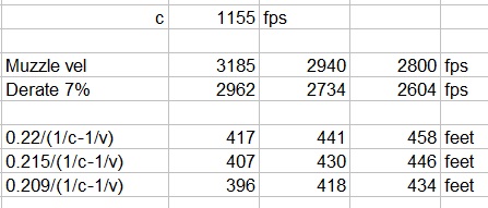

The paper I cited above gave a much higher figure, although sadly they did not specify the bullet mass.
Using an on-line ballistic calculator (with 3200 fps) also gives a much higher figure.
Using a 7% derating puts the available data back into plausible territory, especially given the high margins of error using this technique. If this technique were precise, we would not have a 24-foot spread of outcomes in just 3 samples taken from presumably the same population.
SpeedSpread
Excellent! It’s worth pointing out, and strengthening your argument, that in the equation speed*time = distance, the correct interpretation of “speed” is average speed and not initial speed. What happens if instead of 3000 and 3240 ft/s, you go to a ballistic table and estimate the average speed over 150 yards? Your b would then be a bit lower, and implied function d=d(b) a bit higher … closer to Google Earth. (Btw, I got 467 ft from my GE drawing.)
