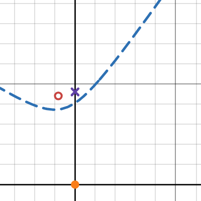

TDOA does not require a synchronized clock. All that matters is the time difference between the 2 sound recorded by mic 1 and the time difference between the same 2 sounds recorded by mic2.
If you wish, you can check out a graph I did on Desmos where you can vary the position of one of the sounds (a,b) and vary the difference of the two time delays (t) and see the possible locations of a ‘second shooter’ (blue dashed line):
