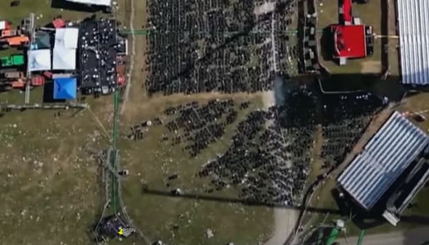

Here is the Middle Bleacher POV, I triangulated the position from the flags and far objects.
Video footage moments before Donald Trump Rally assassination attemptā¦mp4 (dropbox.com)
I can hear 4 shots, IDK if there is more footage.
586744.37 m E; 4523392.48 m N; elevation 1343ft (409.34m) + height 13ft (3.96m)
Here is the RSBN:
The video has a small footage in the top right corner from another POV. IDK if the sound receiver is in that location. Maybe by the sonicboom and report time diference we can confirm the location.
586682.44 m E ; 4523381.43 m N; elevation 1344ft (409.65m) + height 10ft (3.05m)
Which helps us narrow down the possible shooting locationsā¦Besides providing cover from being seen from the parking lot, itās entirely out of sight of both SS sniper teams while still having a clear shot at Trump. Weāll be working to resolve the audio data and echoes against this and one other possibility.
