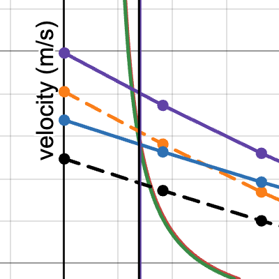

If the distance from Trump’s ear to the mic is 1.07 feet, as your drawing shows, then to match with the 220ms snik-report difference of the 1st shot which hit his ear, the average speed of the bullet must have been 2622 fps as is shown in my graph here:
The assumptions as I’ve calculated and shown in previous posts and are listed in the graph are:
Speed of Sound = 1152 fps
Distance from Mic to Shooter muzzle = 454 ft
I don’t think there are any 5.56 NATO rounds below 77 grain that could travel anywhere near that slow. And even 77 grain rounds would just barely get there.

Average velocity of 2622fps implies a muzzle velocity of something like 2930fps (not precise - just eyeballing). That’s seems doable from a 16-inch barrel with 55 grain to me.
No, the average bullet velocity CANNOT be anywhere near that fast if the following are true:
454 ft - muzzle to mic
1152 fps - speed of sound
220 ms - snik-report difference
1.07 ft - mic to Trump’s ear
It’s simple math. See my post.
That was a reference to muzzle velocity, not average velocity.

Here’s my math, which won’t be as accurate as yours since I didn’t account for the 1ft distance from the microphone, but it’s still close to yours. The two solid lines are average velocities for 55 and 77 grain bullets (solid) and the same shifted down for a 16-inch barrel (dashed).
I had used 141 meters for distance to Trump, but I added your figure. Also used 350 and 352 m/s for speed of sound to add a range and account for a bit of uncertainty.
Just to give you another example:
