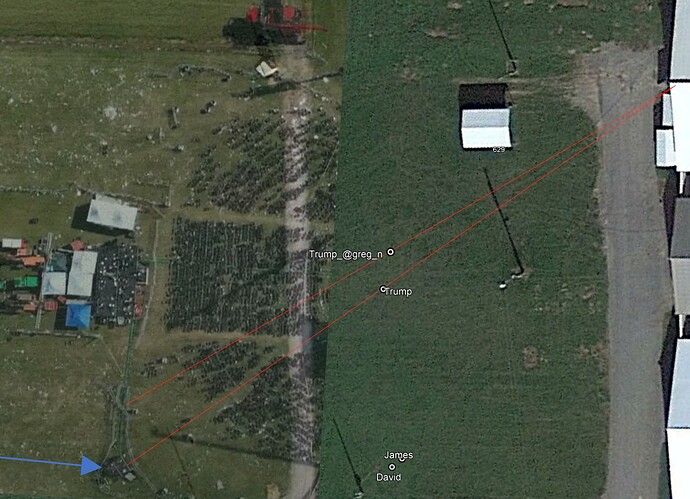

I always use the 11/05/2021 satellite image. Still, this only explains around 2m error to the South-East.
But for Trump position I have 5m error to the North-East.
Here is RSBN footage, Trump is to the right of the top of the north barn. If I use the line of sight from top location on the right of the top barn (red arrow) and Trump location it should trace back to the camera of the footage.
I located the camera from RSBN (blue arrow) on a drone photo and inserted on Google Earth by the closest references. This method helped me triangulate Trump location with more precision.
Your location came too far from the camera line of sight.
