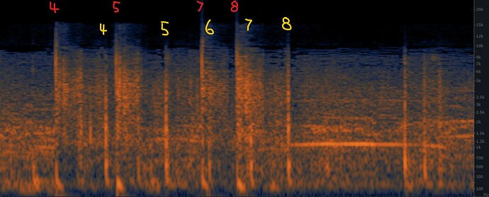

Thanks to the wonders of digital audio and high bit rates, the effect of a limiter can be overcome (within limits of course - har-har).
As an experienced audio mixing engineer, I am somewhat familiar with the curves and values often used in various types of audio gear, and it bugged me we couldn’t isolate those missing reports from Trump’s mic. So I went to work on it.
With a little bit of trial and error, I isolated some volume automation settings that produce a natural sounding result for the first three ā€œsnicksā€ and replicated that automation for the remaining bundle that follow for every instance the limiter was clearly triggered (a sort of ā€œun-limiterā€ result if you like).
The settings are a 3ms attack to a 24db boost immediately following each peak followed by a 30ms hold, then a 150ms release back to unity.
While I question if this would be admissible in a court of law (nothing but volume is altered, which is generally acceptable so long as the process can be reproduced) it does reveal the missing reports, clarify the absence of ā€œsnickā€ #6, as well as a slight difference in tone between the first three snicks and those that follow.
Would love to share, but I don’t know how to upload an audio file here?..
(edit update: files are below!)
In the meantime here is a spectrogram that now clearly shows the last bundle of snicks and reports and where they land in correlation to each other. Notice that the snicks (in red) have a distinct low frequency signature at @150hz and the reports (in yellow) are more focused to the midrange…

I’m an audio engineer and I see you’re using audacity to analyse the audio. How come you’re not using a spectral view? If you do you’ll get an extra dimension of data.
Waveform (like audacity) you get amplitude and time but with spectral view (like adobe audition) you get amplitude, time and frequency/pitch.
The audio image is also much more detailed and you can isolate any small section. In spectral view you can see things like single bird chirps.
