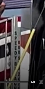

I was disappointed last night watching Chris display the CAD drawings of the bleachers. They weren’t representations of the Speedy Bleachers that were actually used at the rally. Instead, one of the “Big 8 Assumptions” indicated that specifications for Belson Standard bleachers were used. Why would one do that? If Chris’ staff would read the forum, they would see that the factory design drawing of the Speedy Bleachers was actually provided in post 114 on July 30. This is important information that could have (should have) been shared with DMonk.
Another one of the “Big Assumptions” that I have a problem with is the height of the stage. I too looked at video showing the Secret Service personnel standing by the stage in order to estimate the height and noted it was near the middle of their rib cage. At 6’ tall, that area is about 48". Now on that short little Secret Service lady that couldn’t holster her weapon, 40" might be around her shoulders and that would throw all dimensions off. The height of the stage, and therefore the height of Trump’s ear is critical to this investigation. Too bad that stage wasn’t part of the J6 investigation, we’d know every detail about it.
Note to DMonk, if you need a copy of the Speedy Bleachers drawing in .dwg format, I can provide that.
