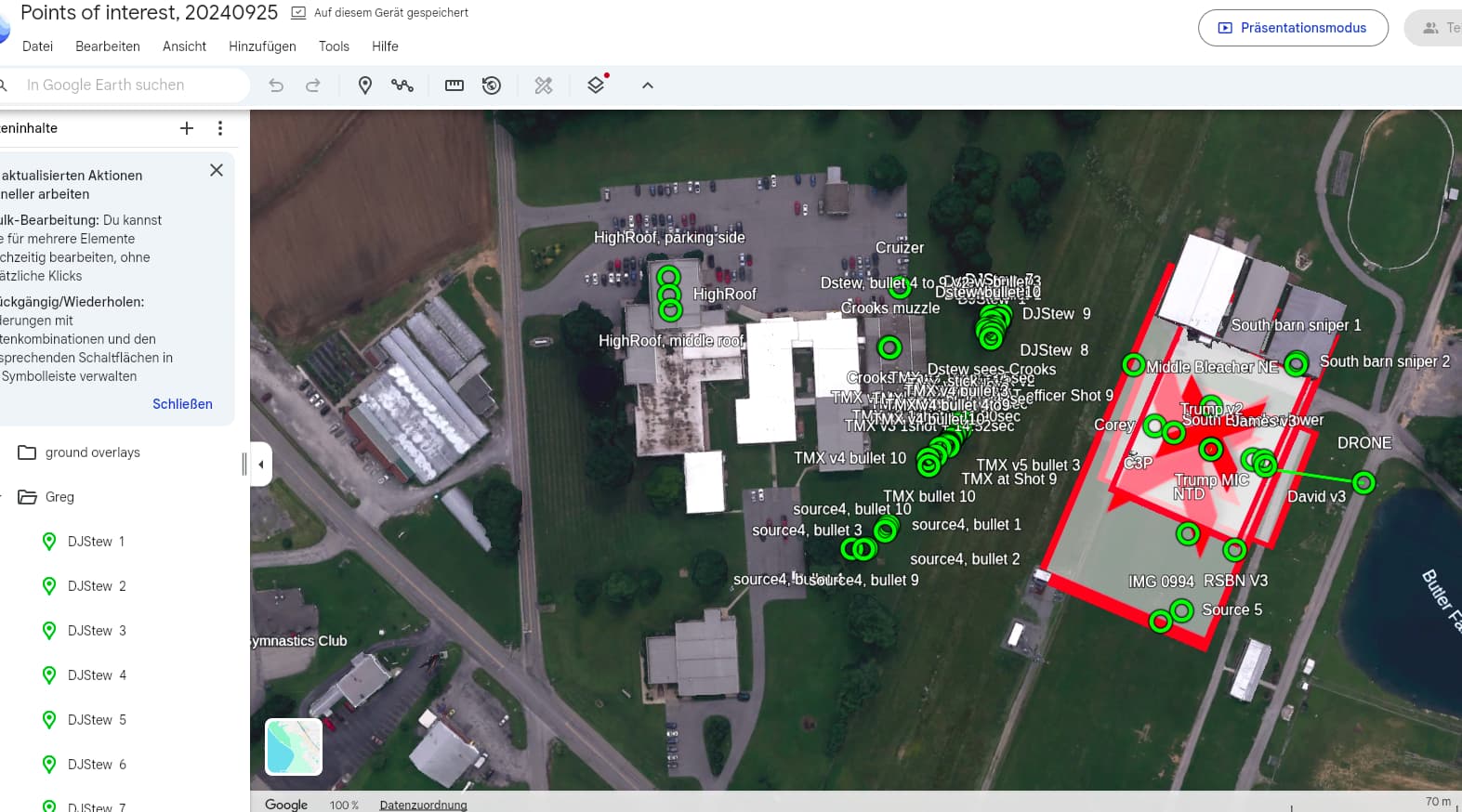

Can you give me geo coords + elevation?
Or at least a location on an aerial view?

Open the .kml file from September 25, 2024 in Google Earth.
https://raw.barf.bz/howdoiknowthisinfo/kml/

Thanks. That could be extremely helpful if it’s accurate. Who placed the markers for the videorecordings?
I take it you’re referring to the three circles on the “High Roof”? Do you prefer one of them?

@howdoiknowthisinfo together with other members here in the forum over one year ago
