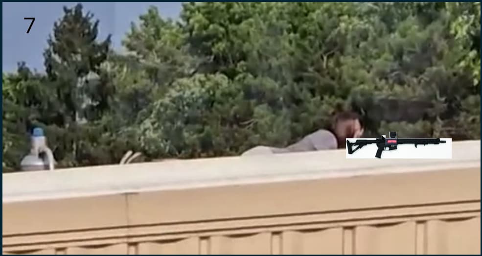

yes, if he fired the first 3 rounds, he must have been over the ridge cap, and that is NOT the position from where the alleged ejection of the shell casing “from his first shot” can be seen…
you may recall that I mentioned in a previous post that there must have been a reason why they blurred part of the muzzle stock of crooks’ rifle in the following photo:
given the source photos of the animated gif I got from @sorey, we now know why they blurred/cut that part of the photo: it is IMPOSSIBLE that he fired any rounds from that position for the very simple reason that he would shoot into the roof, even below the ridge cap:
  1. this is the first frame from Sorey’s gif:
  2. this is what they selected and showed:
    so, the white part and the blurry part left of it are not shown, but if we overlay the evidence photo over the contour of the rifle from the image shown in 1., you can clearly see that the muzzle would fire straight into the roof, UNDER the ridge cap
  3. still the same frame, but highlighting the location of the ejection port by means of a red overlayed version at the exact position and 1:1 ratio:
  4. this is the first frame with the alleged shell casing:
  5. it is hard to see, but this is where believers see it:
  6. if you compare this frame with the first frame, you can clearly see that the arrow of the second frame points at something that is not present in the first frame:
    the left top corner shows the frame number, and it is clear that the first frame does not show the thing that is present in the second frame, and that thing is near a location that could make sense if it were ejected from the red ejection port
  7. so, in the first frame, there is no “ejected” shell casing to be seen; it appears in the second frame, it is gone in the third frame, another lighter spot appears in the fourth frame, and that same spot remains at the same place in the fifth and subsequent frames. in the following frames, the orange arrows indicate that “something will appear there in the next frame”, the yellow arrow indicates “that something”, and a redish arrow points at “something that was there in the previous frame”:
neither Sorey nor myself have modified any of the images, they come straight from the TMZ video.
the only thing I did was shift and resize (keeping the aspect ratio) each frame such that subsequent frames have the same reference points:
  • the position of crooks’ left shoe
  • the strange thing on the left with the blueish top
  • the diagonal roof line
  • the vertical line of the rightmost wall panel
and what turns out?
  • crooks’ shoulder does not show any sign of recoil absorption
  • some of the subsequent frames have been stretched such that the vertical wall panels are a bit wider or smaller between frames
by stretching or shrinking the image making the vertical wall panels wider or smaller, you get the impression of recoil and dynamicity of crooks’ body, even though he remains reasonably stationary in these frames…
the individual frames with the anchor points are the following:
if you save these images on your computer and move back and forth between them, you will see that the images are all very well aligned, and you will see that there is no shell casing that gets ejected from that rifle…

if he kept the gun at eye-scope height, it would have looked like something along the following lines:
note that he would still shoot through the roof if that was his shooting position…
it is really impossible that he fired any shots towards the rally area from that position, as the ridge line is even higher than the vertical separations between each roof lane:

I took your pics with the lines and made another gif. Somehow I still see a casing flying/spinning to the west (towards the guy filming). It first ascends, spins 2 or 3 times on its peak height and then dropping down to the roof. Making kind of a bow line. Max height level with the top end of the first bunch of tree leaves in the background.
gif shot 1
Please Note: the screenshots are taken on different times (~27m between), therefore the shadelines are not the same.
Here is where the casings on the northern part of the roof were positioned. Since it’s a hard roof and there’s the lane separators, the casings may have bounced back going funny directions. There’s also a possibility that somebody on the roof (willingly or unwillingly) had influence on the positions of the casings in the time before these screenshots were taken.
