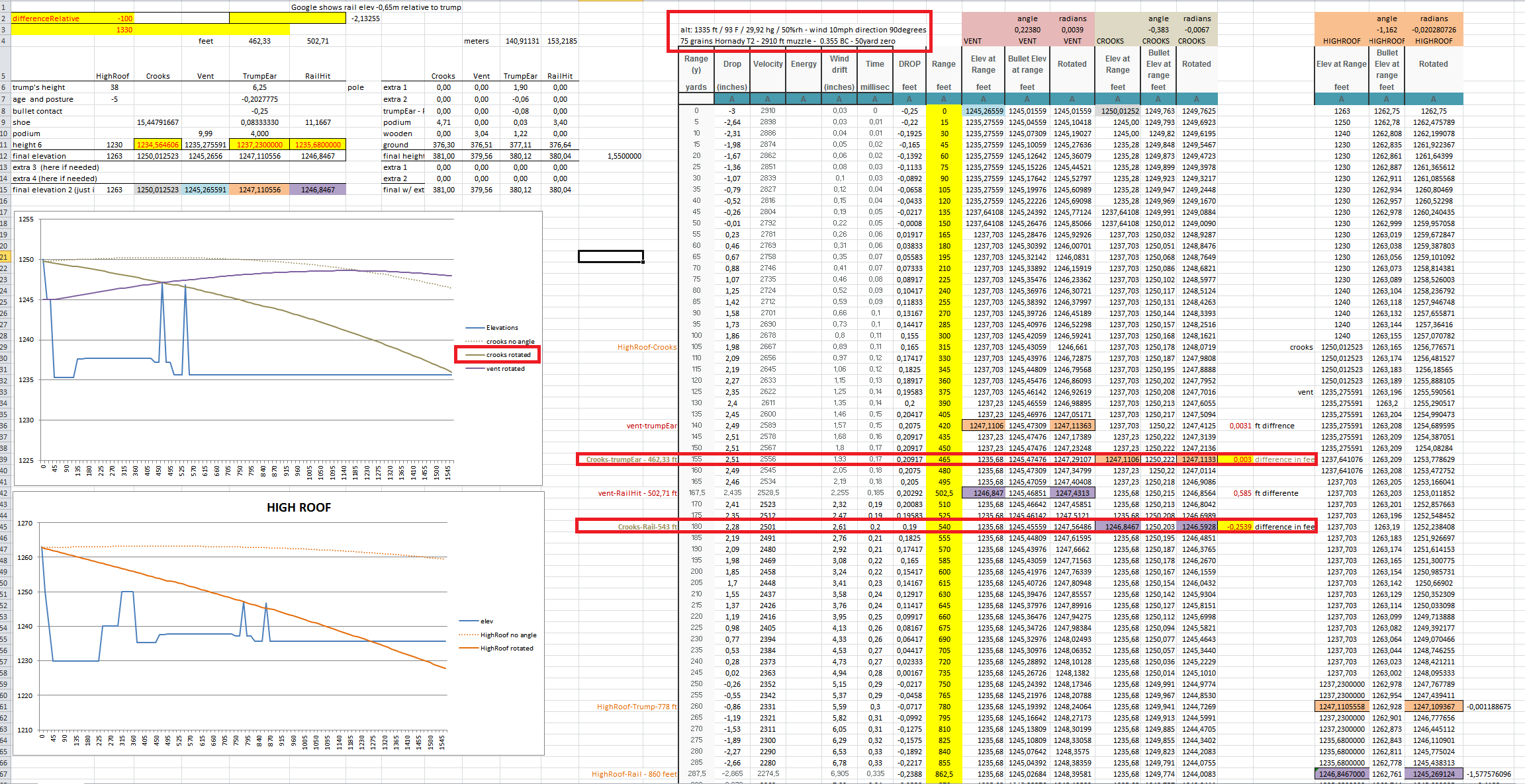

Out of curiosity, I took the liberty to input your values on that trajectory spreadsheet (just ignore the 100ft difference, all points have it, it’s leftover from after that paramount tactical video). The bullet used for the ballistic drop is that fav candidate of mine from that ammo-data spreadsheet which has the objetive of identifying ammo from the crack-thump sound and average velocity… Hornady 75 gr BTHP Match T2 Frontier (pretty much the same as the LE version: 75 gr BTHP T2 TAP PRECISION®).

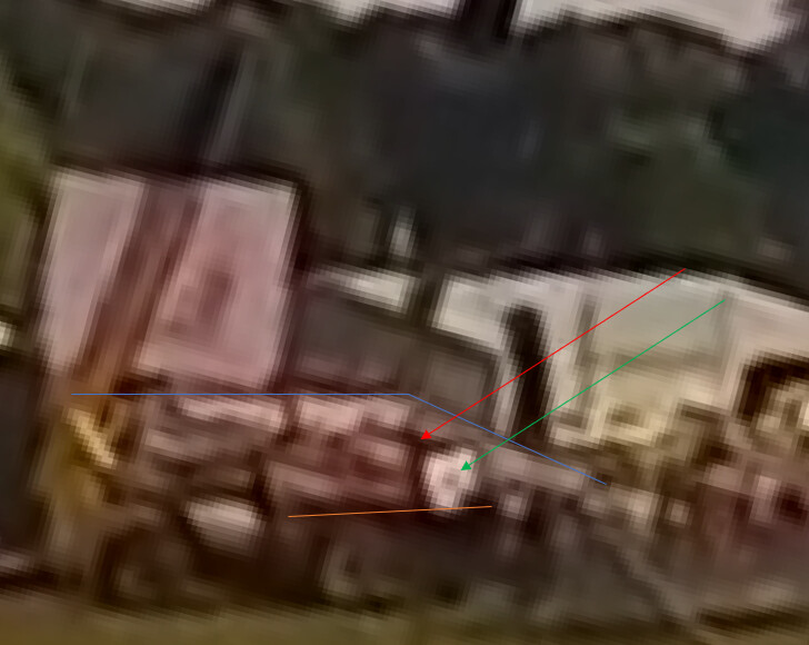

I maintain that without definitive elevation data, it’s technically impossible to determine between CrooksOnRoof and that ridiculous Vent theory. On this image below, for instance, considering the elevations are all correct, if you add 1 ft to the bleachers, then Vent is possible and CrooksRoof is not (EDIT: well, CrooksRoof would still be possible, just at a lower impact point on the rail). However, Google shows that the bleachers’s ground is 2,13 ft below podium’s ground (yours is 1,55ft below)… so there’s google’s accuracy at play, etc… Another user at one point used another topo data website he had access to. But still… it’s tricky…

Another point of view. A little above Crooks.
zoomed:

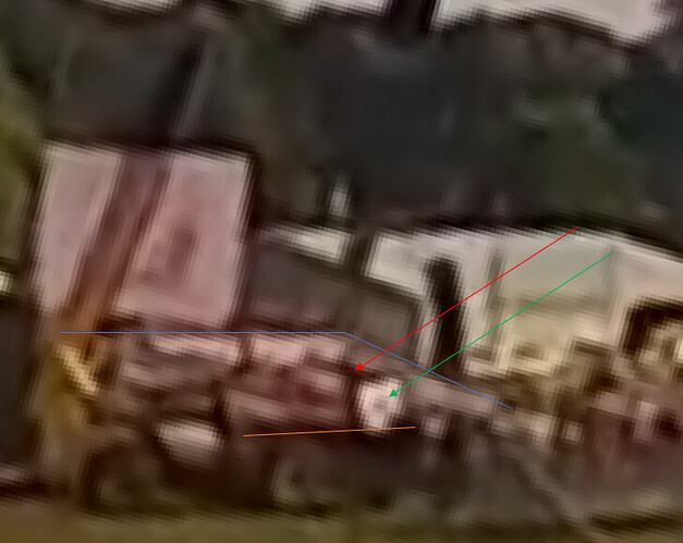

Trump podium have the white reflective flag on the front (in green).
Probably Trump mic support (in red).
The rail of the South bleacher (in blue).
Estimation of Trump podium floor (in orange).

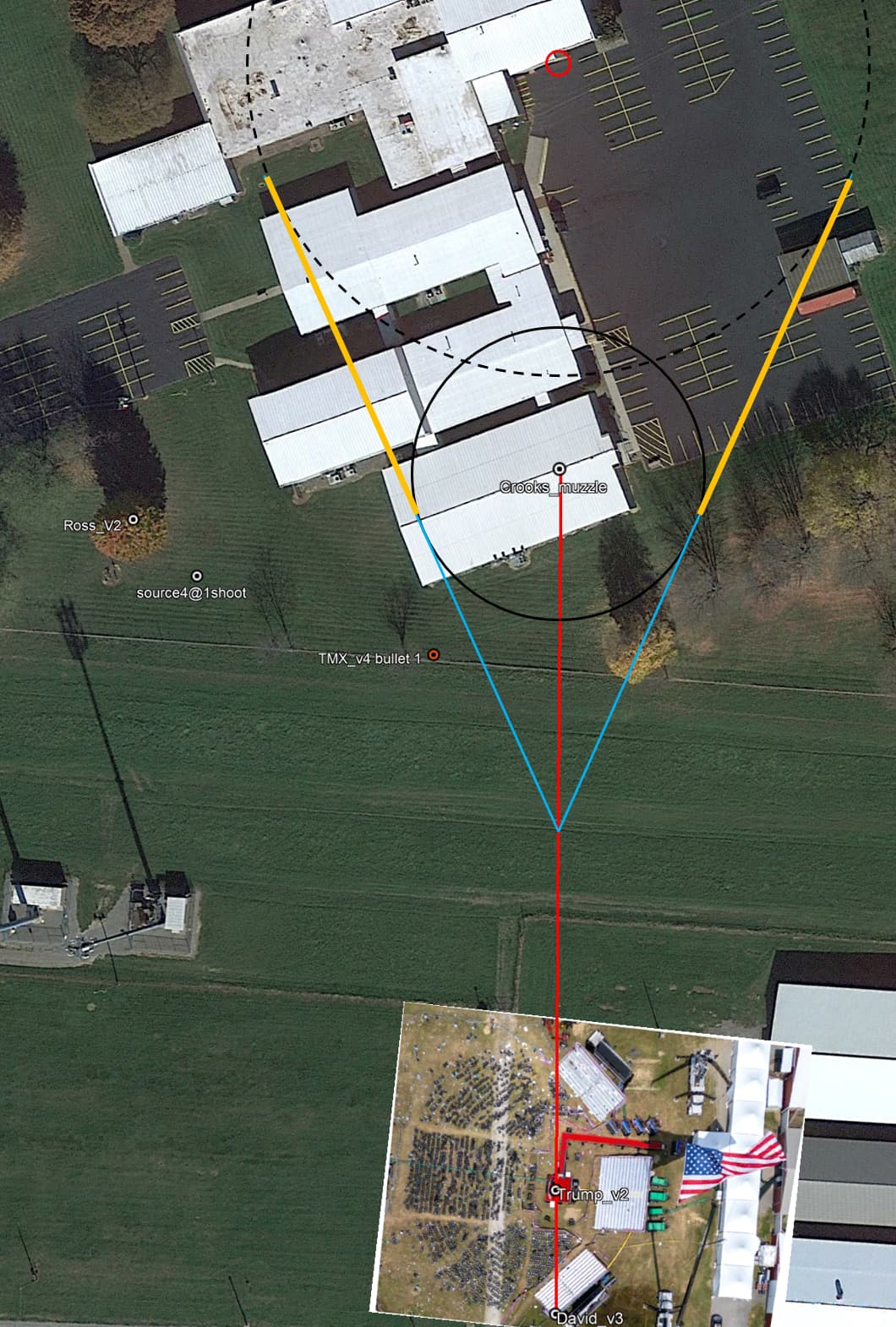

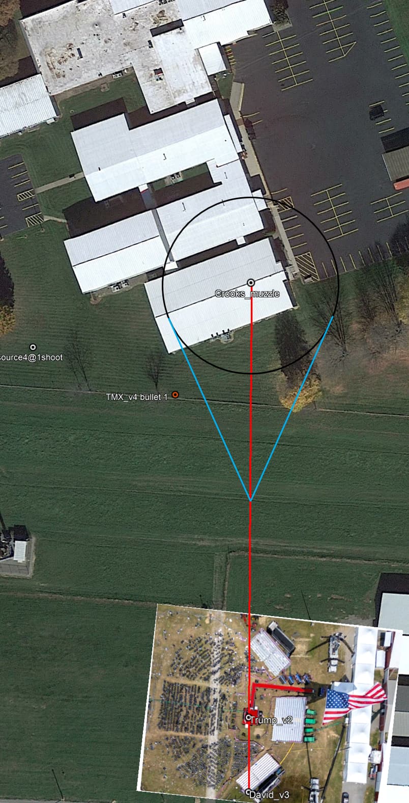

I’m going to sketch your scenario. First the basic scenario were crooks fire a gun alone. In black is the report and in blue is the Mach cone that produces the crack after 0.1sec.
Now your scenario is a gun fired from the back (in the small red circle) ahead in around 0.09sec before Crooks “fake” shot. For this scenario the gun used by crooks would have to be fired with a delay by some remote device. Then the gun from the back has a suppressed report represented in dashed black circle.
Now can you see the difference from the 2 scenarios? The Mach cone from a fire from behind (represented in yellow) is not suppressed like the report. Therefore, it will reach Ross audio before the “fake” report, keeping in mind that the crack from the first real scenario would not reach this audio. Since there is no audio of crack of the first bullet on Ross audio therefore this suppressed gun theory is not possible.
