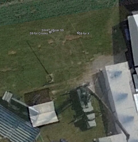

After carefully analyzing the data, considering the times corrections for shot 10 proposed by @greg_n, I can definitely say that all shots from 1 to 8 came from Crooks position.
Here is the map of medium error for predicted positions of shot 9 and 10 on Crooks position.
The minimal error is very close to Crooks position. And in the hypothetical scenario we consider position X (the location with minimal error) as the shooter, the location for shot 9 and 10 cames way off the positions the snippers on roof of the south barn and the position the SWAT officer. Therefore, to believe the shots 1 to 8 came from another position implies that shot 9 and 10 came from odd places that do not fit with reality.
The cause of the error not been optimal at Crooks location derived from measurment errors for positions and times, sound speed estimation and possible sound diffractions in some cases.

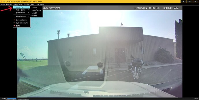

Shot 1 happens on the dashcam time 18:11:32, and on Dayve’s video at the mark of 04:55. The start of Dayve’s video should be aligned at the dashcam time of 18:06:37. Adjust from there, matching the peak from the shot on both audio tracks.
Thanks, I was trying to align the new enhanced version though and that sound clip doesn’t include the gunshots. I’ll have more time tomorrow to review dstewarts video and get a good alignment for syncing them together.
Video sync: Here you go. It’s in sync using shot 1 as reference, but I left just the conversation to reduce file size. Also, the audio is amplified and I added a zoom effect, which got the timestamp offscreen. The first frame from this clip on the server is from dashcam 18:13:42.
Wow, sounds great! Thank you! I should have used this file for that sync, instead of the original (maybe on the weekend I’ll reencode).

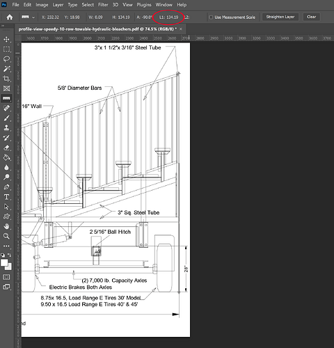

You can find the manufacturing drawing here:
Manufacturing Drawing
To determine the height of the bystanders using Photoshop, follow these steps:
  1. Use the Measure Tool to measure the 28-inch section and note the number of pixels.
  1. Go to Image > Analysis > Set Measurement Scale > Custom, and enter the appropriate scale values.
  1. Verify that the 28 inches measurement is accurate.
  1. Measure the height of the bystanders, which is 134.19 inches, equivalent to 11’ 2”.
