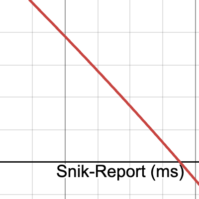

Does this information align with Chris’s echo data? Do you suspect the muzzle was poked through the vent, or behind (inside) the vent? If you believe your back tracing is correct how do you (we) prove the shots came from there?
Your question doesn’t make sense.
But if you had a microphone that was 775 ft from the shooter muzzle, and there was a snik-report difference on that microphone of 220 ms, and the average velocity of the bullet was 2622 fps from shooter to point of closest approach to the mic, then the bullet would be approximately 173 feet away from the microphone at point of closest approach.
So if you are talking about Trump’s mic, this is NOT possible. Because the bullet was only 1.07 feet awat from mic at closest approach.
so, what would the average velocity of the bullet have to be in order to have that difference of 220ms if the shooter was 775 ft away from the microphone?
I have not yet done sound analyses, hence my crippled terminology, but I am getting to that analysis after the ballistic trajectories that I am adding to my kml files…
1715 fps

I will feed my ballistics trajectory model with bullet speeds starting from 1600 fps and up and see where we get…
