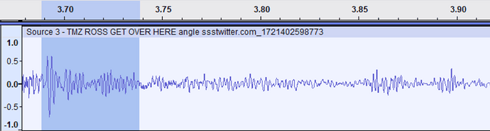

I just looked at shot 1 from TMZ: there is some in-band crowd noise, but I tried to reject everything over 1 kHz, and I see some ringing and two reflections at 600 Hz, which match the original report:
Original report at about 3.69 seconds, ring 1 at 3.72, ring 2 at 3.86, and ring 3 at 3.89. All have the same frequency and are probably true echos, which may sound like rattle with all the other noise competing.
In the car audio, I would expect a rattle to be set up by and continue from the sound that excited it, like in the last five shots that I looked at for Chris, when the rattling source is so close to the microphone. I would also expect it to exhibit one or more sharp resonant frequencies. The “echoes” in the car audio are delayed and have a broad peak that matches the broad peak of the initial sound, they just have much more high frequency content than the initial sound, and no resonances. So, weird when compared to other sources.

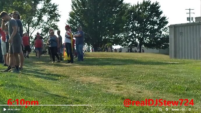

Look at the guy on his phone right there in the grey shirt and shorts at the “end” of the fence line of people. Wasn’t there a plainclothes guy in that area also constantly on his phone around then?
I’d love to know if there was some sort of phone app meeting call (Skype, Zoom, Discord, etc…) going on in that area at the time leading up to and after the shooting. And if so: who were the participants?
