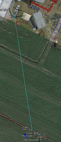

Yes. Those all look very good, but I did do some tweaks to the @vt1 positions of TMX for shots 2-8 to get converge better. For example:
586727.26-0.6, 4523504.62-0.5  %TMX at Shot 8
Looking at the TMX video, there seems to be a little bit of cameraman movement between shots 8 and 9, but not much. However, I found it necessary to tweak the position at of TMX @ 9 like this
586727.26-1.5, 4523504.62+3 %TMX at Shot 9
in order to get TMX to align with the other recorders, improving the error from 3.8 m to 0.9:
But that means that TMX would have moved 3.6 m between shots 8 and 9, which seems unlikely given the video evidence. So, that’s what is troublesome.
Yes, that’s the method I have been using to refine the recorder positions, but your suggestion has prompted me to try something new. Keeping shots 8 & 9 together, I’ll use Matlab to try all the lat/lon positions over an XY grid to find where the error is minimized.
When I understand that the sound analysis does not correlate to the geolocation’s estimations, my though process is that there is room for improvement in those geolocations, but I will not try to move a position to fit the sound analysis.
Also looking at NTD and Podium time differentials they should not exist because both of the receivers are still. Yet there is 0.002sec differences in some cases that results in 0.7m of error.
I’m trying to find the reasons for that error.

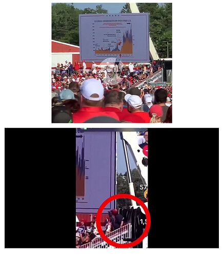

I posted this a while ago:
This is the closest photo I got for the location of where the bullet hit.
I still, to this day, cannot find the bullet hit in that photo.
